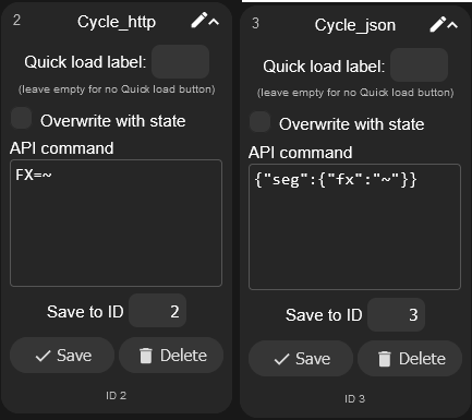

Not really sure of the issue you are facing other then TT as http://10.0.6.74/win&FX=~ works for me and
also {“seg”:{“fx”:“~”}} when called directly , in presets or mqtt
