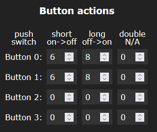

I was so focused on the “not interrupting playlist” idea that i didn´t see the obvious:
2 Playlists, on for “moving” (6) , one for “ready” (8). I use 2 Reed-Switches, so the only thing to do is to config them like this:
Works perfect now !
