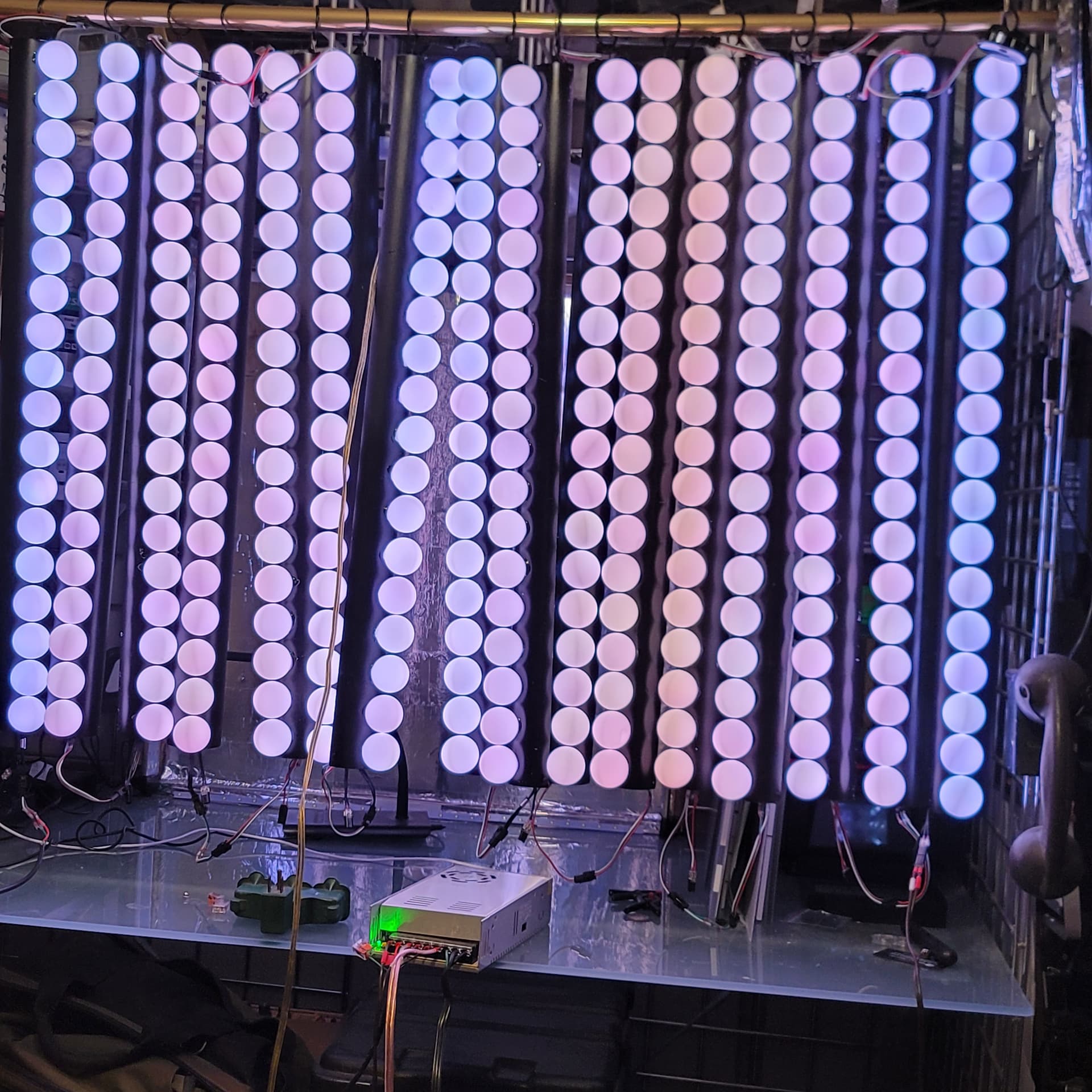

I have a string of WS2811 (link below) with 288 leds, with 60a P/S. They are in physical sections of 18 LEDs per stick (30in PVC pipe =stick). I connect them with JST SM3 connectors (link below). I have power injection at both ends and middle (14awg to the JST connector). When I test with solid white and brightness at 200+ I see drop off on the brightness after at the 36 LEDs at the injection points.
36 LED * 0.06a = 2.16a cellulated getting through the string. Voltage drops from 5.17 at injection to 3.98 after 18 LEDs.
With this configuration it suggests that I need injection every 36 LEDs to see the white without fading.
I have bypassed the JST at the injection point and connect the LED power injection leads directly to the 14awg wire. No improvement.
The JST connections between the sticks of 18 LED are 12in or less.
Are the JST connectors an acceptable connector for this many connection points? If not what is recommended and suggested length of the connector cable to LED connection.
My initial project goal was to use for our craft show tent. But after I completed the project I see I’m going to use them for other applications. I have 16 sticks of LED with 18 LED/stick. Kind of like pick-up sticks, I can arrnage them in various configurations and setup WLED to animate.
Anyway, thoughts of JST connector and my fading white lights?
