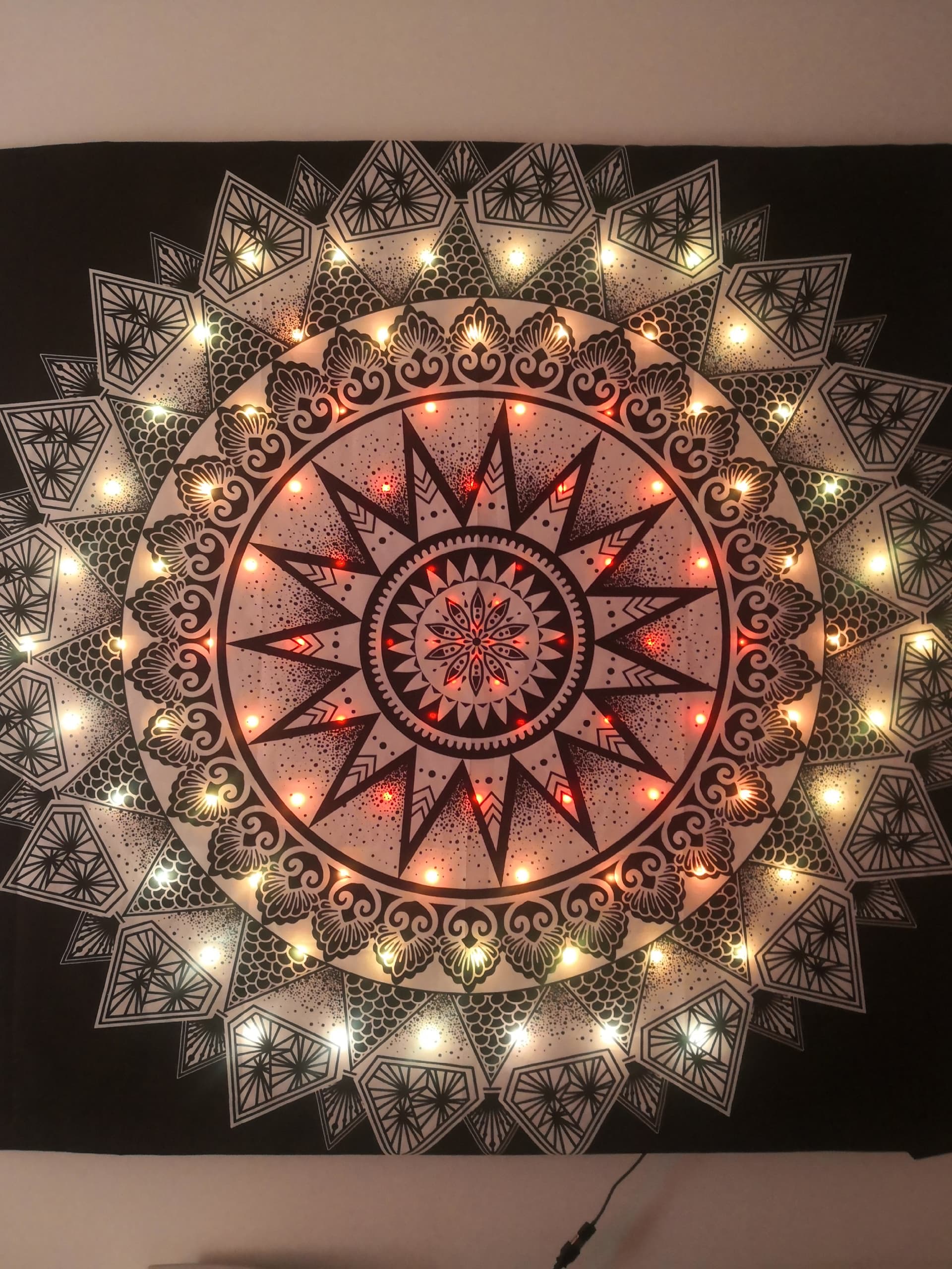

This sounds interesting, do you have a link?
My array looks like this
It is fairly simple to add ledmap as per the example here Mapping - WLED Project , the hard bit is which ledmap works better with most effects . If you have your fixture mapped as matrix in 2D then you might also get better result
