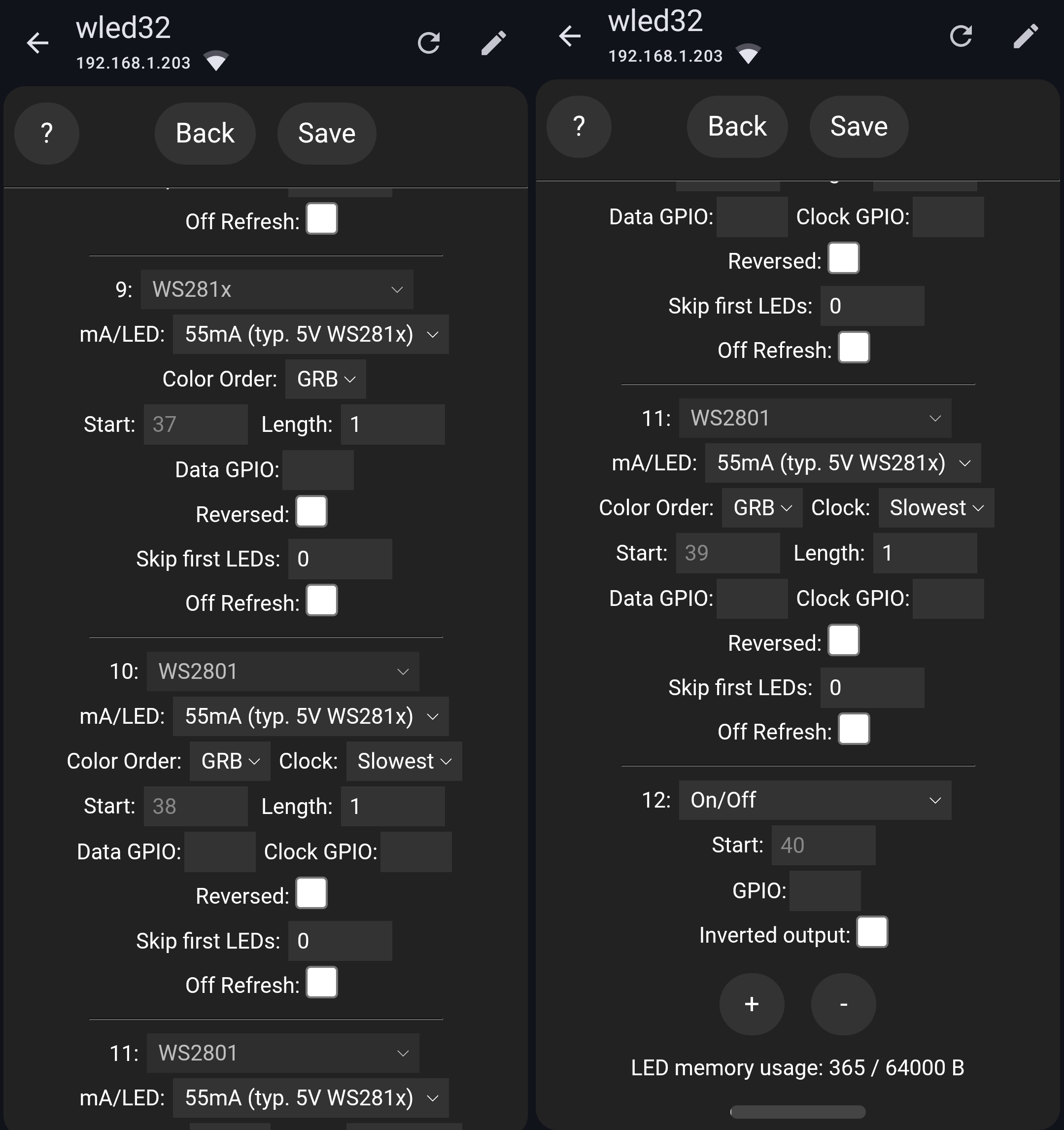

***Actually Never mind. I just tested it and once you get to #10 it no longer lets you select WS281x.
Looks like @dedehai will have to provide more info.

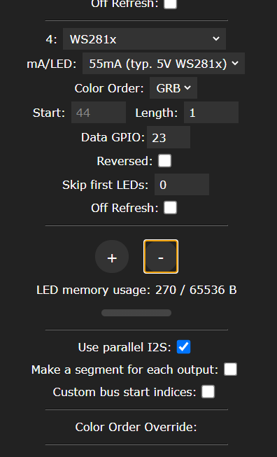

enable parallel I2S and it will let you add more
Can I ask a stupid question: how to do this? ))) Somewhere in the Usermods settings?
Thanks dedehai.
Once you add the 4th output you will see the box for parallel I2S. Edit it’s actually once you add a second output not 4th
Ah, so that’s it. I myself would not have noticed that another option appears. Thanks. It remains to try. I have now made a controller from arduino but it can only be controlled by wire, I have long dreamed of making it wireless and wled is a pretty good option to use an almost ready-made basis.
Take note that WS281X only goes to 17. The 18, 19, 20 you have there; 2 are on a different protocol and 20 is On/Off.
Yes, I understand that, in principle even 12-15 will be enough for me.
In case someone finds this topic. The final result. To use more outputs, you need to check the “Use parallel I2S” box. It appears if you add 4 or more outputs.
