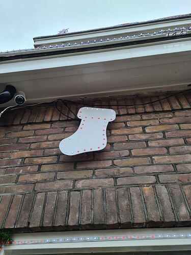

Here are some closeups of my setup
2 controlers, 30A 5V power supply, 2 12V adapters for camera and snowflake light. And some garland and christmas decoration to cover up the connections of the windows. (I live right on the street, the sidewalk is right up against my house, so it has to look sort of nice during daytime…):slight_smile:
Strips, pixels and fairylights mixed together. On the flat roof everyting is held down with bags of stones or with clamps.
