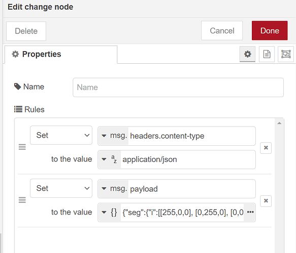

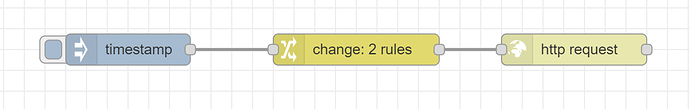

I figured it out.
here how to do it in case someone else have the same question.
Nodes:
Change Node:
HTTP Request Node:
thank you. ive been riding the struggle bus and this kinda helps take me down a new road
