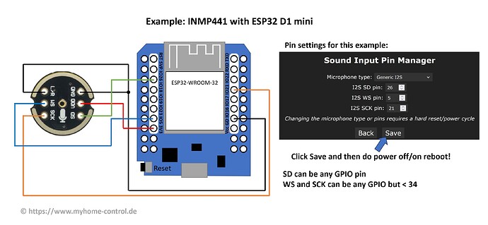

this is my pinout.

Hey y’all. I’m having the same problem with the same hardware. I have tried the wiring suggested in the photo above. I’ve also tried different GPIO pins to get it to work.

Current Pin Config:
SD - 32
SW - 18
SCK - 19
VDD - 3.3v
GND - GND
L/R - GND
Nothing I am doing has worked. Currently beating my head against a wall. Any help would be appreciated. Thank you for reading!
