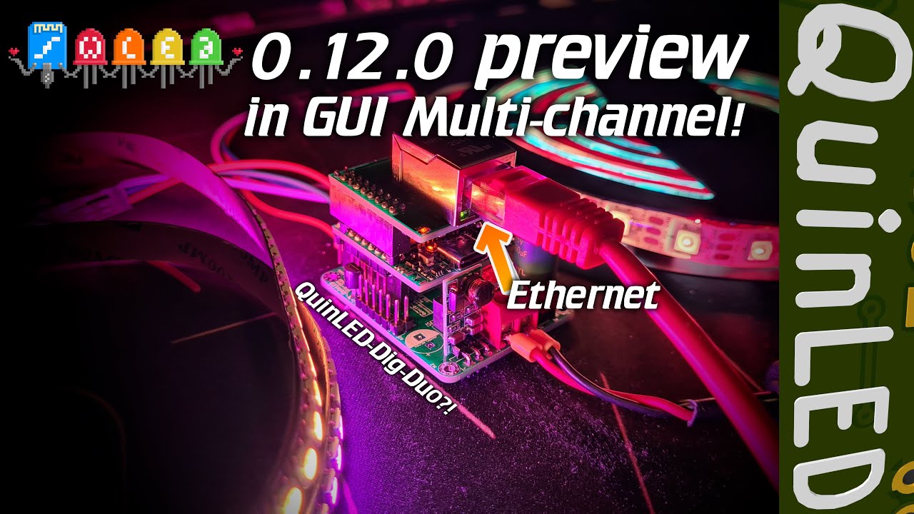

By coincidence I came across a Hikari (WLED 12) video that might be of your interest:
Personally, I see no benefit for normal LED strips myself as most of the applications can be covered by segments. Multi output only has the advantage that it can do transitions, which segments cannot up to now - a real miss for me.
