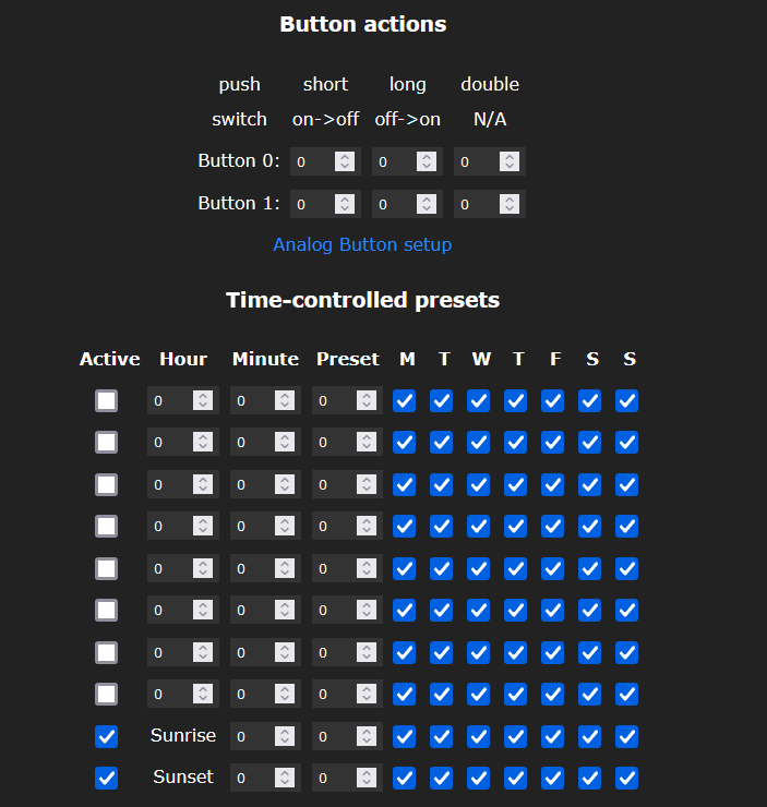

thanks again, but I don’t want to specify a time, I want that it uses the caluclated sunrise and sunset to turn it on/off. how can I do it?
Sunrise/set is below that on the page. :wink:

The general idea with Sunrise/Sunset events is to use the last two entries under “Time-controlled presets” to activate a preset at Sunrise/set offset by +/- some minutes. Normally you’d use a “lights on” Preset at sunset +15mins (my preference) and a “lights off” Preset at sunrise -15mins. I use this in many instances, it works very well.
The actual Sunrise/set times are calculated dynamically by WLED based on entered Lat/Lon and corrected for UTC offset/time zone. Time of day is updated via NTP so the daily sun times can be adjusted on the fly. Your page shows what seems to be the correct Rise/Set times for your Lat/Lon. You just need to enter the correct Presets in the lower “Time-controlled presets” section.

It works for me exactly as you have shown.
Per your example:
10 minutes after Sunrise time (shown at the top of that settings page) Preset 1 is activated.
20 minutes after Sunset time (shown at the top of that settings page) Preset 2 is activated.
One of the tricky parts of testing this stuff is you have to wait for each of these times to actually occur before they trigger. These triggers only happen once very 24Hrs so if you miss the time you wait til tomorrow or add large offsets to prove that they will trigger at a particular time.
I just noticed you had “Timed-Light-Over Presets:” set to 1, you’ll want to change that to 0 and make sure you’ve got the Timer (Night Light) turned off when you’re testing this as well. Start with very simple presets, no effects just to verify operation.
