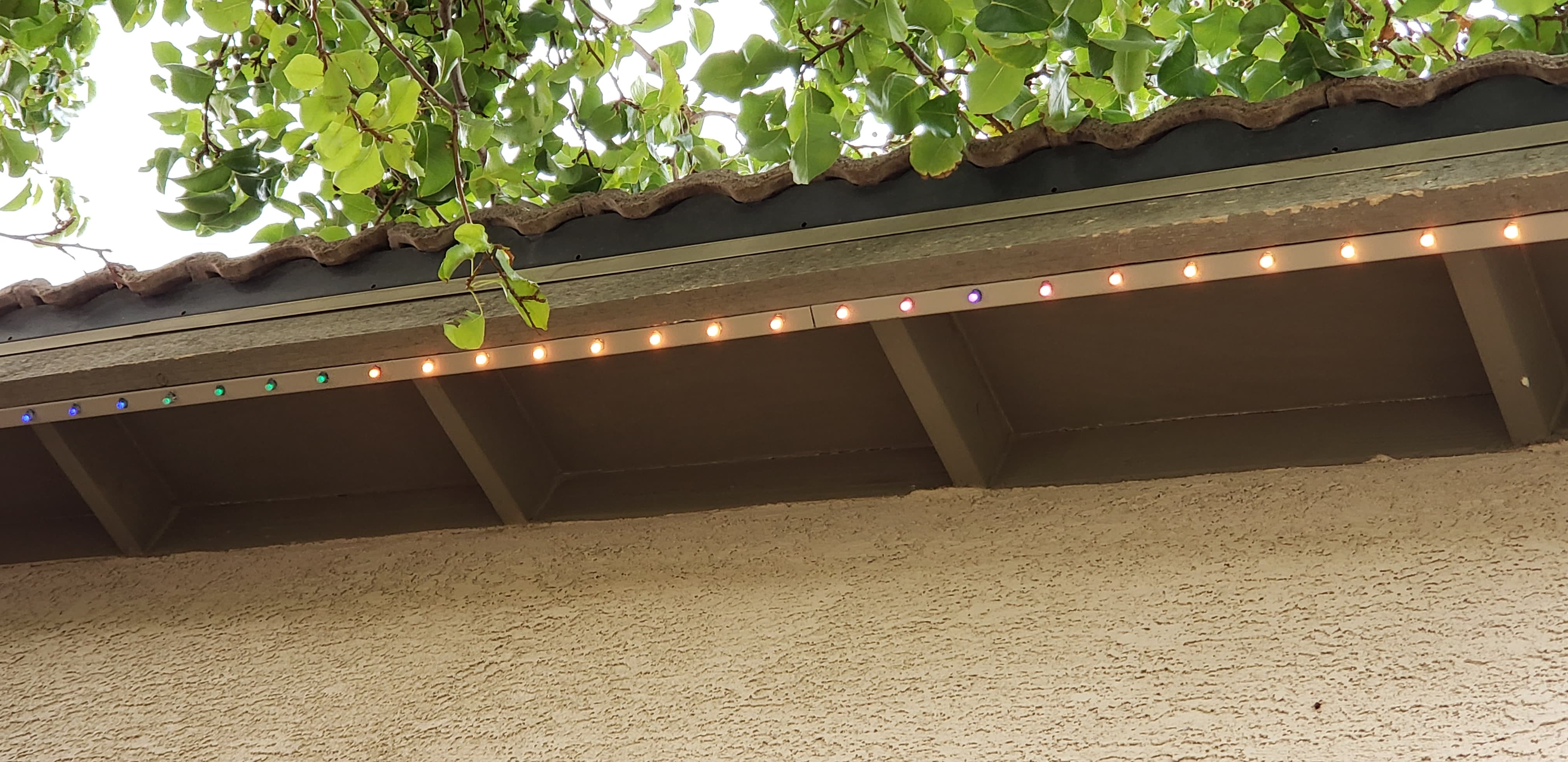

The test I had on one setup was mountain dew colors this one is on my house using the Utah Jazz colors of green, blue and yellow. The center of the yellow color which is the 3rd color selected is wrong, see attached…
I have 5 ESP8266’s synced on my house with one set as the master with all the presets on it. They are all showing the same issue with washing machine. Thanks
