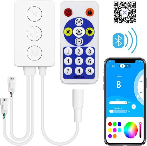

If it makes a difference, here are the LEDs that I am trying to use with WLED to eliminate the need for multiple apps.
The controller that they were previously connected to worked with the BanlanX app.
I appreciate any help.
Thanks
Controller made by Alitove is not supported by WLED project. Maybe they have some place discuss their products.
300 5v LEDs you likely need a couple power injection points.
I want to eliminate the Alitove controller and use the board above and one app to control multiple products.
