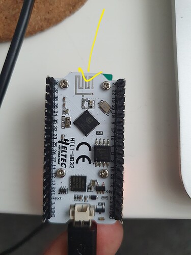

After long debugging,
I was able to find the error.
It is a hardware problem or the design of the board.
The built-in wifi antenna is no good.
When I put my Finger on it everything works.
Thanks
Jinx
October 18, 2022, 3:49pm
11
if it’s this: WiFi Kit 32 (Phaseout) – Heltec Automation It says it’s discontinued. Maybe they had issues with them. If those screws are attaching an lcd on the other side maybe the screen is reducing the wifi signal.
