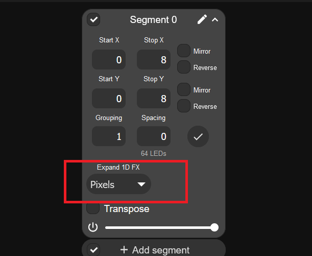

i have issues when changing mode from scrolling text to 2D animated custom matrix t ( see picture )
this change make 1D effect pixel will be invisible than chnged automaticly to
fix1
then make my animated matrix show not correctly
then i must enter effect into solid mode only for make expand 1d effect effects to PIXEL
then enter again my preset animated matrix to show normaly

The eye means segment are frozen , this will be the case when you use individual led control , use {“seg”:{“id”:0,“frz”:false}} to unfreeze , for the expand 1D FX you can use m12=0 to get pixels

to solve it i need to change manualy use solid mode , then i enter to segnent tab then i change 1d effect from bar to pixel. (its same as value m12:0 as i see on json documentations )
but i see m12:3 on my json stats
i believe this is the main problem

hey i found that problem as u said ,
the main problem its we need to add that 2 value and i try on default gui 1st
and the result is
the m12 should be 0 and frz should be false and i put manualy on running text presets
{"on":true,"bri":20,"transition":7,"mainseg":0,"seg":[{"id":0,"start":0,"stop":8,"startY":0,"stopY":8,"grp":1,"spc":0,"of":0,"on":true,"frz":false,"bri":255,"cct":127,"n":"mytext running here","col":[[255,0,255],[0,0,0],[0,0,0]],"fx":122,"sx":120,"ix":128,"pal":11,"c1":0,"c2":128,"c3":16,"sel":true,"rev":false,"mi":false,"rY":false,"mY":false,"tp":false,"o1":false,"o2":false,"o3":false,"si":0,"m12":0},{"stop":0},{"stop":0},{"stop":0},{"stop":0},{"stop":0},{"stop":0},{"stop":0},{"stop":0},{"stop":0},{"stop":0},{"stop":0},{"stop":0},{"stop":0},{"stop":0},{"stop":0}]}
1D effects its unavailable to access after changing mode to running text then i force m12 to pixel and frz i force to 0
thats now running smooth between 2 transitions thanks @ALDIY 2 thumb up
