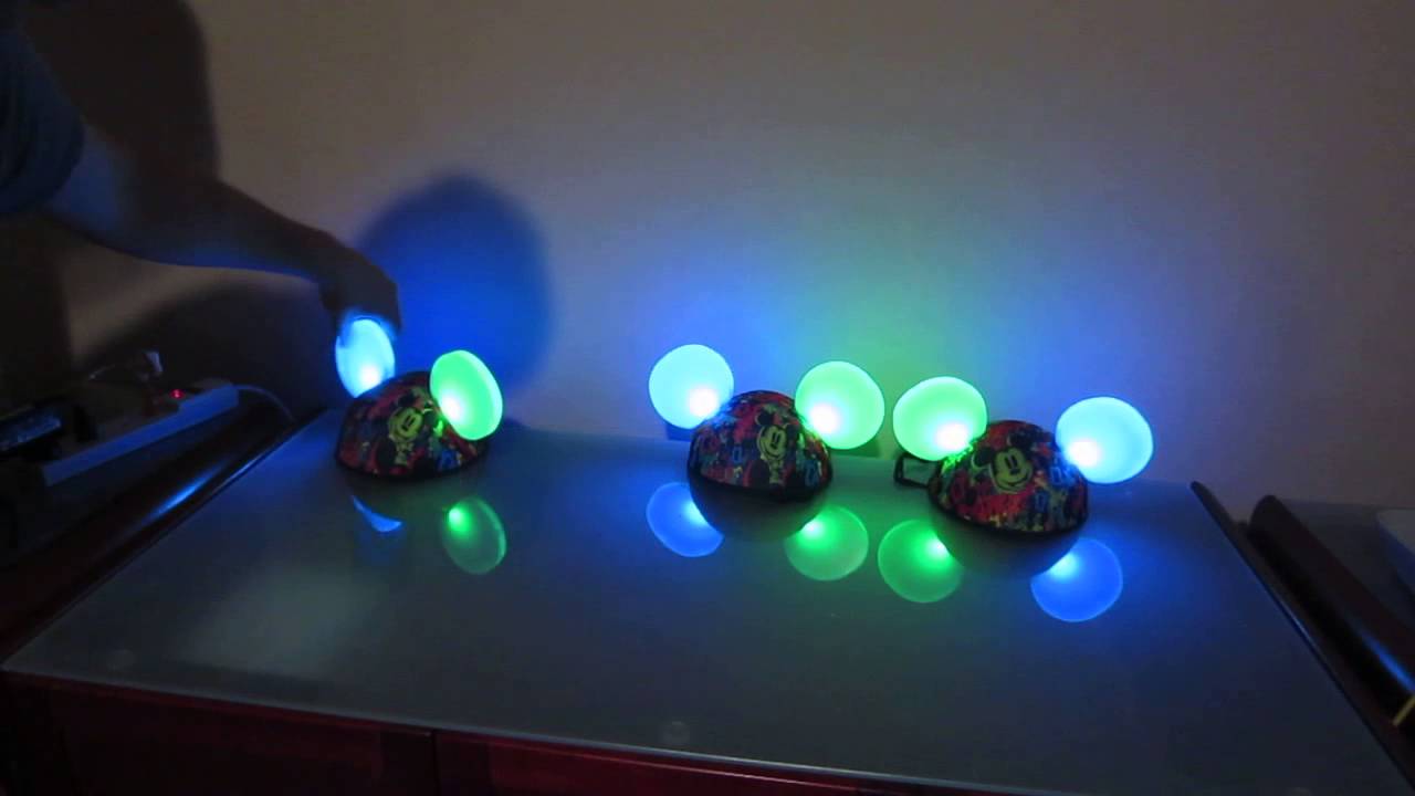

Similar but older, Walt Disney World and Disneyland started selling Glow With The Show Ears in 2012. They were IR controlled and synced with several of their live performances. Unfortunately, they didn’t really catch on. Probably in part because of the additional cost of an already expensive souvenir. They started with just Mickey Ears but later added additional items and most importantly a “wand” that could control them at home. Another reason I think they failed was the wand took more than a year (maybe 2) to come out which limited the functionality outside of the shows. Although they did sync with other “Ears” near them (my daughter being significantly shorter than the rest of the family would often fall out of sync)/
Well before the “wands” were released, fans figured out they could be controlled with a simple reprogrammable TV remote. There are teardowns on the internet, but basically, they have IR receivers and broadcasters, and LEDs and are powered by 4 AAA batteries. I knew they were finished when I could longer buy AAA batteries in the parks. Some even more industrious fans made IR blasters and synced with their Christmas displays.
My family bought and wore them for years including last year when we went back. They don’t sync with much anymore, but it’s still fun. I have been meaning to build an IR blaster to control them since back then. I’ve only recently actually started to build LED displays and the like. I want to add them to my “Tiki Bar” where I have my wLED lights installed and sync them. I think I will have to get xLights up and running first though. I also plan to install an RFID reader (through Home Assistant) to read the Magic Bands that may soon be obsolete.
