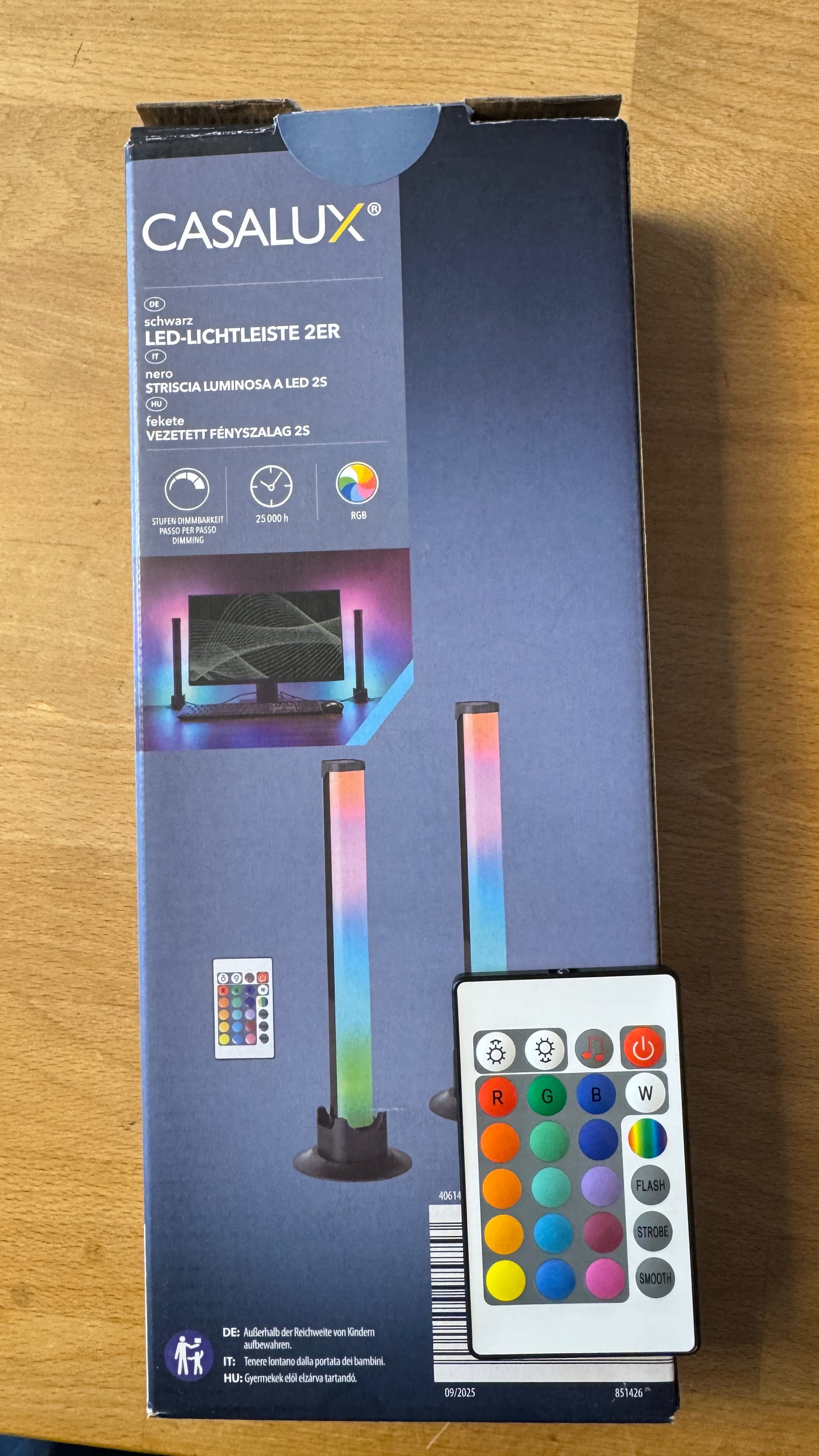

On last Aldi Retrofit: small LED columns
After this I will stop, I swear :wink:
Another offer from Aldi is the two small columns with 14 LEDs each, which are powered by a USB-A and therefore with 5V.
The columns are connected with USB-C style plugs but they are wired proprietarily.
I recycled the connection cables and also desoldered the IR receiver from the small pcb. I then wired everything to a ESP32 D1 mini. I sniffed all the buttons of the 24-button remote and assigned them to commands that are near what is printed on the remote control (ir.json attached…)
