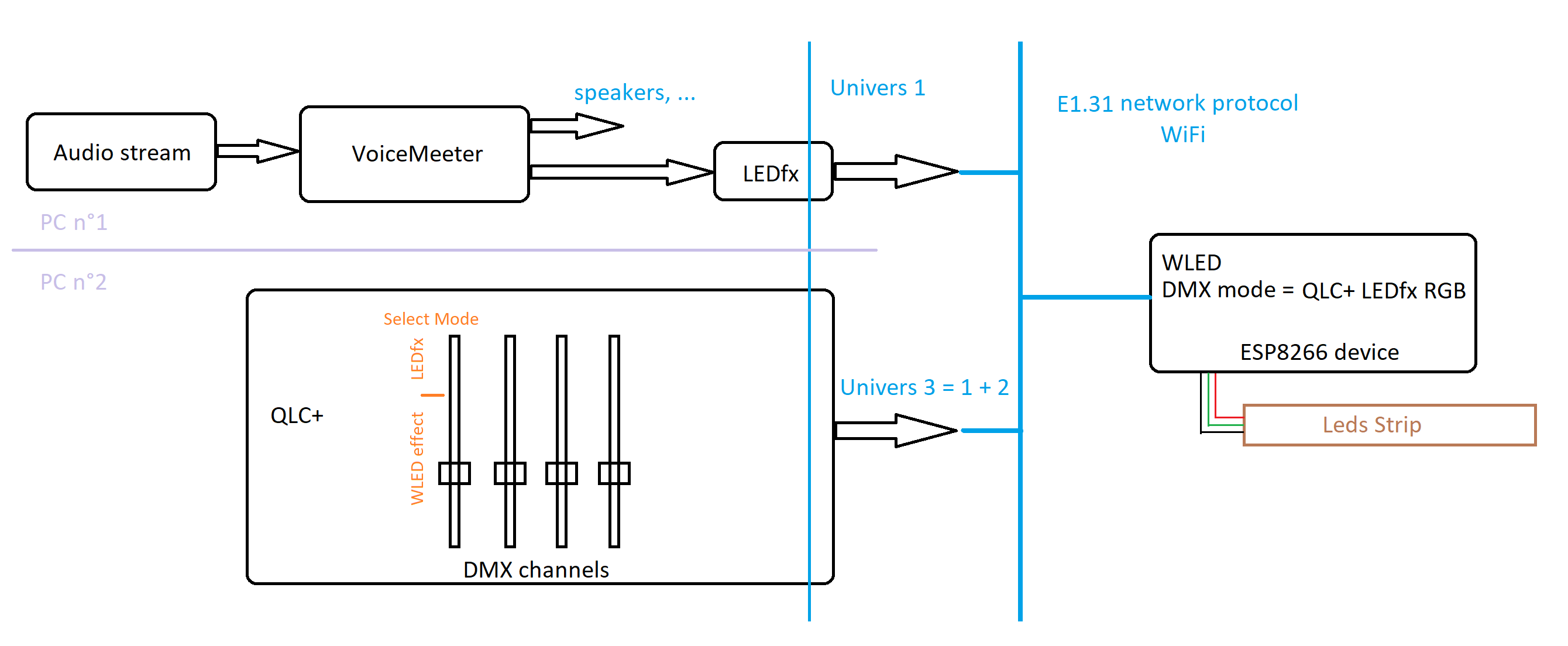

I prefer to modify the WLED source code because I want to control my LEDs simultaneously from QLC+ and LedFx while maintaining the 2 E1.31 (sACN) reception streams in WLED: DMX and RealTime. The changeover from one to the other is therefore instantaneous.

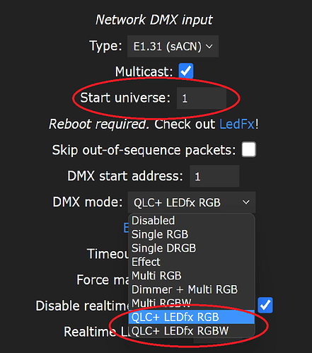

For this I created 2 additional DMX modes: QLC+ LEDfx RGB and QLC+ LEDfx RGBW.
These 2 modes differ in that the second manages RGBW LEDs (4 colors), the first only RGB (3 colors). They work on 2 different universe.
If one of these modes is selected, WLED responds to the RealTime LEDfx stream on its current universe (=1 in this example) and\or to DMX commands on a second universe = current universe + 2.
In LedFx configure Device like this
In QLC+ Input\Output settings use a specific univers = current LEDfx univers + 2

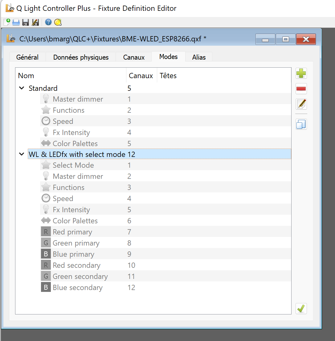

To switch from DMX mode to LEDfx mode and vice versa, I added an new DMX channel: Select Mode
  • value <= WLED effects number: DMX mode (effects range : 0 - 117 in my WLED version)
  • value > WLED effects number: RealTime mode
Now, with 2 PCs, I can simultaneously control my WLED devices from QLC+ and LEDfx also thanks to this architecture.
