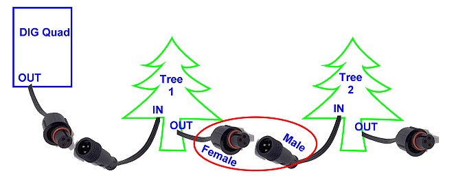

If you cut an xConnect extension in 1/2 that would give you a male pigtail and a female pigtail. To connect the 2 trees one after the other in series you would have to connect the Female pigtail to the output side of tree #1 and connect the male pigtail to the input side of tree #2 (Data only flows 1 direction through pixels). Then screw the xConnect ends together and it should work *If you have changed your total # of pixels in WLED config and segments.
If you tried splicing your xConnects to only the input sides of each tree you can not connect them together, again because data only flows 1 direction.
If connected like my pic it should work as long as the distance from tree 1 to tree 2 is less that 10ft give or take
