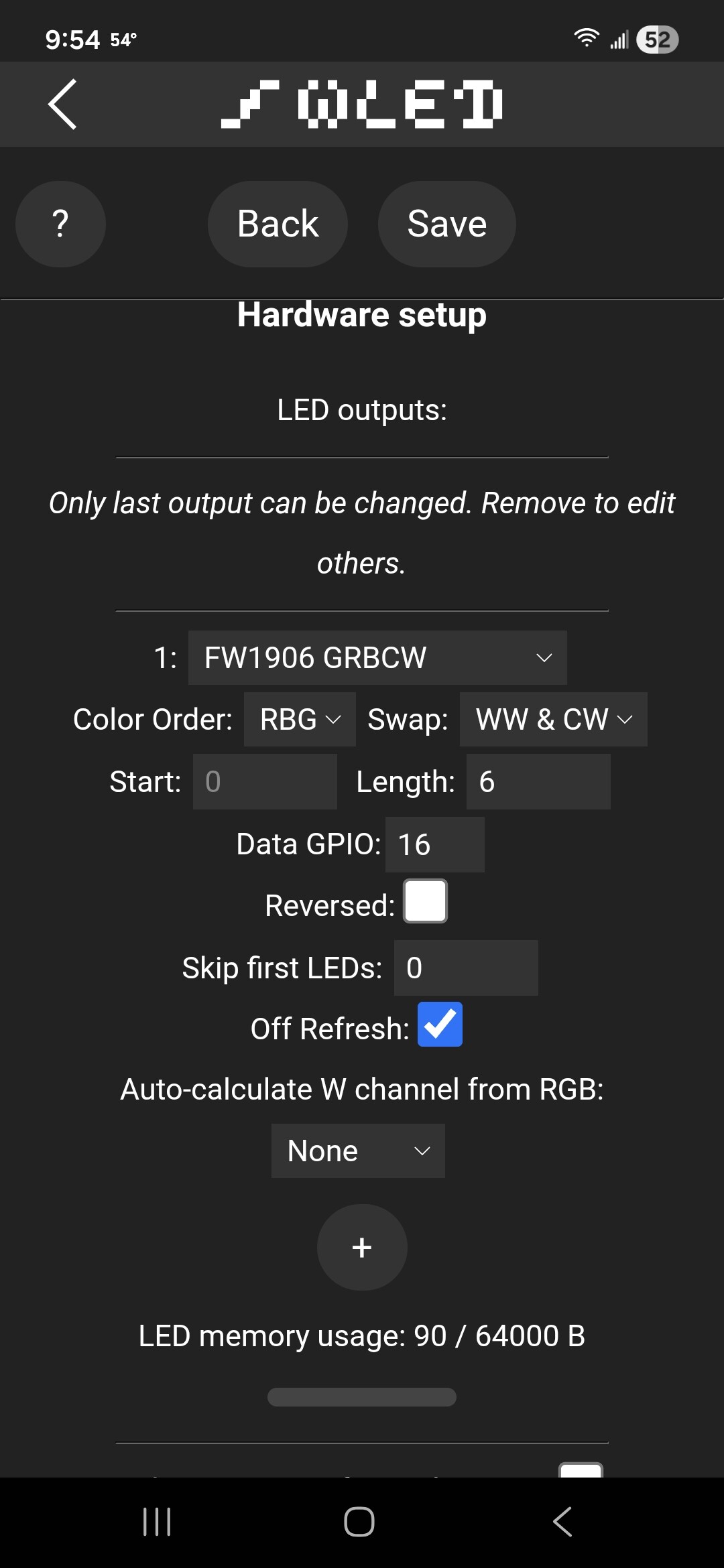

Got some Lumary spotlight pro’s for a good deal with the hopes of running them with wled. 24 volt with red +, blue data, black ground - confirmed by opening the the controller box. I’ve tried ws281x and sk6812 with DMX muti rgbw on and off and all the different color orders with nothing working correctly. With all 6 hooked up 3 are blue when set to red and the other 3 are white. No matter how many leds I set I can’t get all 6 to stay the same color. I saw the cheaper 12v lumary spot lights will work with wled that I did buy but returned before trying wled due to their low light output and terrible not adjustable warm white. It’s either fake rgb white or the worst warm white I’ve seen.
Looking for suggestions to try with the 24v lights.

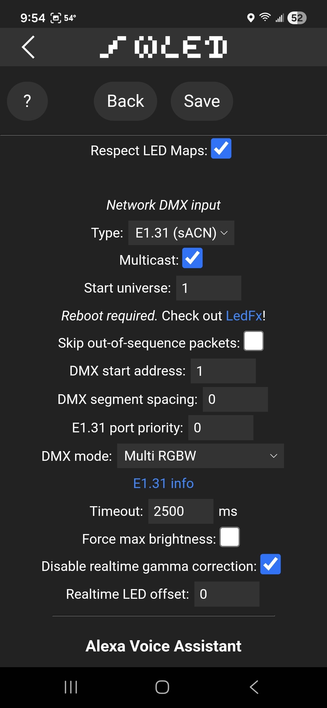

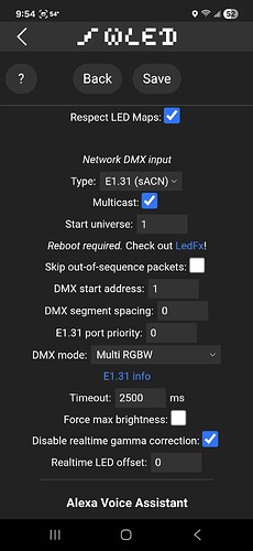

I did get it to work. Here’s the settings I used.
