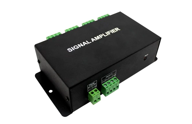

Looks good, but struggling to find out any info on it - does it work with WLED?
Since it says “amplifier” I’d assume it has no controller. It just buffers the signal.
It simply takes a data signal, amplifies it and gives you 8 outputs. I have one currently running 6 WS2812b outputs from a ESP 8266 controller. Excepts data and clock signals so works with most other controllers as well.
