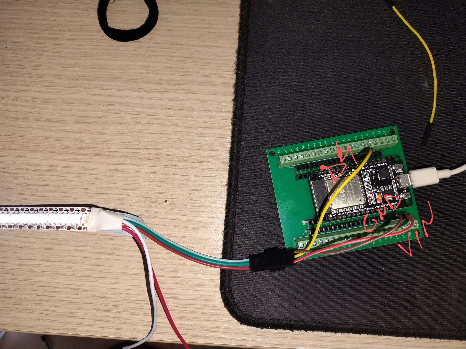

Hi everyone, I’ve been trying to get this WS281* led strip to work with an ESP-32 using the software for a few months now. I successfully installed the wled software in the ESP and connected the led wires using small jumper cables. The strip turns on and lights up white but there’s no way to get any commands to work from the site. Could you help me? I’m attaching a photo of the setup.
check arrows.
What do you mean?
Maybe i understoon, the lights in the leds are now correct, but no signal anyway. i can only see that if i’m moving a little the data cable only the first led change color but not always the desired one
stick to the wiring guide.
