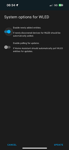

Further to resolutions above, I found another fix for the light flashing randomly. Seems to stem from home assistant, when both my wled integrations are disabled in home assistant, the flashing stops. Alas, once enabled again the random flashing resumes. I “disabled polling” under the device options and that has solved my issue.
