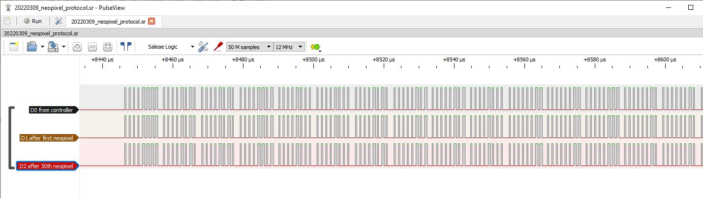

It was my bad - I actually encountered a string of weird neopixel-like LEDs which appear to have internal addressing implemented. This means that independent on their position in the string, the LEDs pass through all bits in the stream and react to a certain position which must have been programmed into them during production or more likely assembly.
I found a description here: https://twitter.com/todbot/status/1343692604769103872
and my own analysis confirms this function. So if you want to repurpose these types of neopixels which are otherwise fully WS2812-compatible you need to know the original length of the delivered strip and the start position of a substring…
These are known as fixed address pixels.
