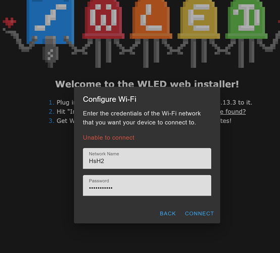

I tried to make it run for days now but no matter what, it never connects to my wifi and I found no way how to check logs or somehow find what’s the issue for WLED.
I flashed WLED_0.13.3_ESP01.bin many times both with web and esptool-v3.3.2, always erasing the flash before
I created exactly same network with some ancient no-name AP and it connects well
My AP is years old Vodafone-branded cable modem/AP/router box made by Compal
There are no special characters, channels or features (I know of) enabled on the Compal
While my DHCP server knows the mac address and offers the IP address, I cannot ping or reach it via browser, there is simply no response from the device
Any ideas, how to debug that connection issue, please?
