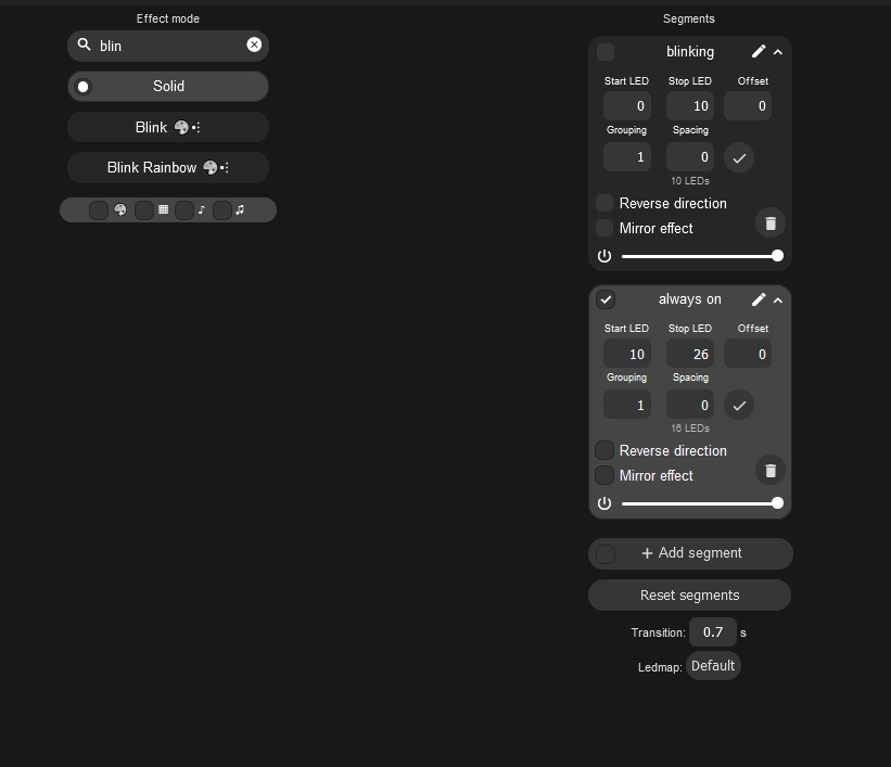

Not sure that is the question but , i setup two segments one ( blinking 1-10 and always on 11-26)
I see the first segment blinking and the 2nd solid . I have no strip to test but only matrix but should be exactly same but if you setup like that and does not work then show segment config or video

do you have 2 segments doing two different things saved under the same preset?
Yes you can have more then one segment doing different effects and that can also be saved under the same preset. Try it out
